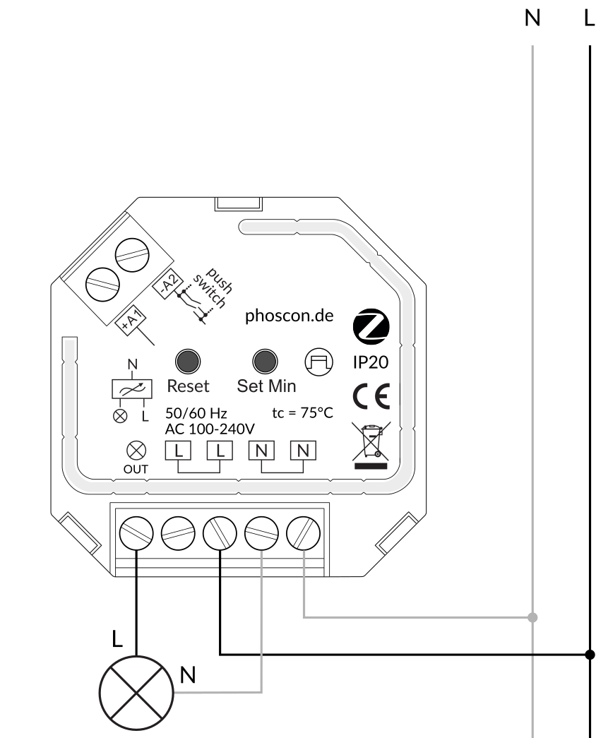

Wiring
Attention danger to life!
Disconnect the power supply before putting the unit into operation!
Installation may only be carried out by qualified personnel!

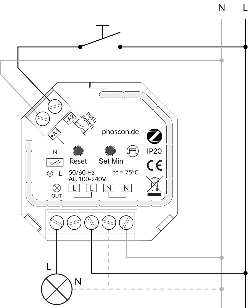

The Kobold can be connected with or without a push button, as shown in the following wiring diagrams:
Connect Kobold with push button
Connect Kobold without push button

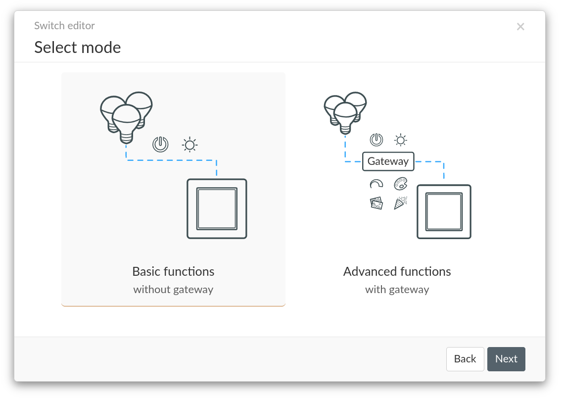

With a connected push button, the Kobold can control other Zigbee lights.
The configuration is done via the Phoscon App switch editor and is described under Phoscon App Documentation / Switch Editor →.

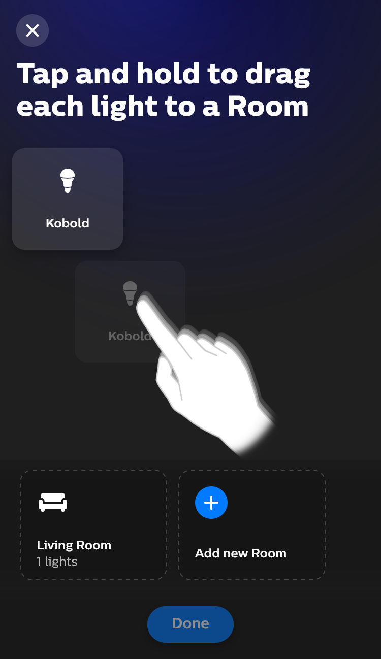

Philips Hue Bridge

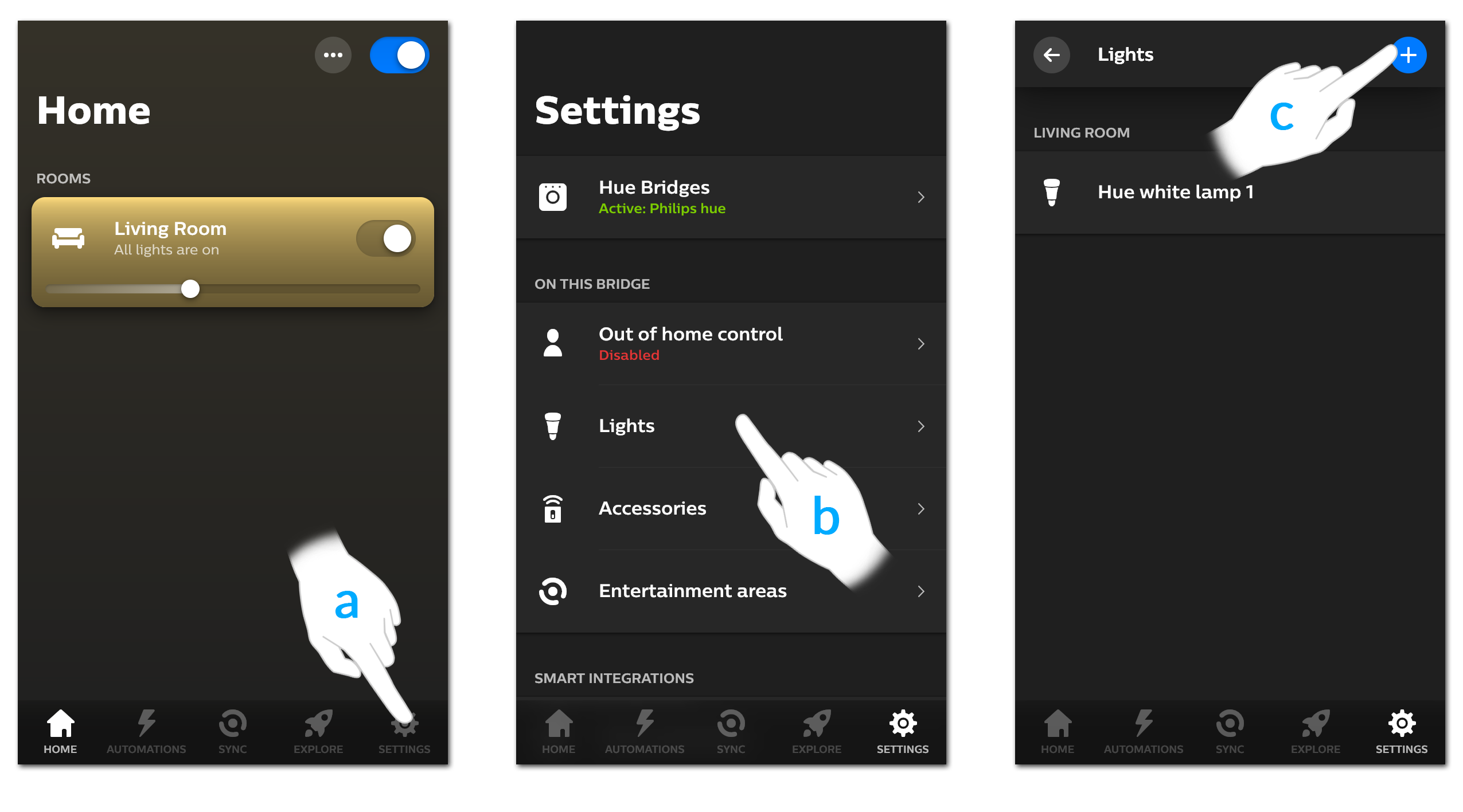

Open Philips Hue app
Go to device search
- Settings
- Lights
Start searching.
Press the Reset button on the back of the Kobold briefly 5 times.
… Kobold will be added as a dimmable light.
Assign the Kobold to a room and the pairing process is complete.
Philips Hue app assign light to livingroom

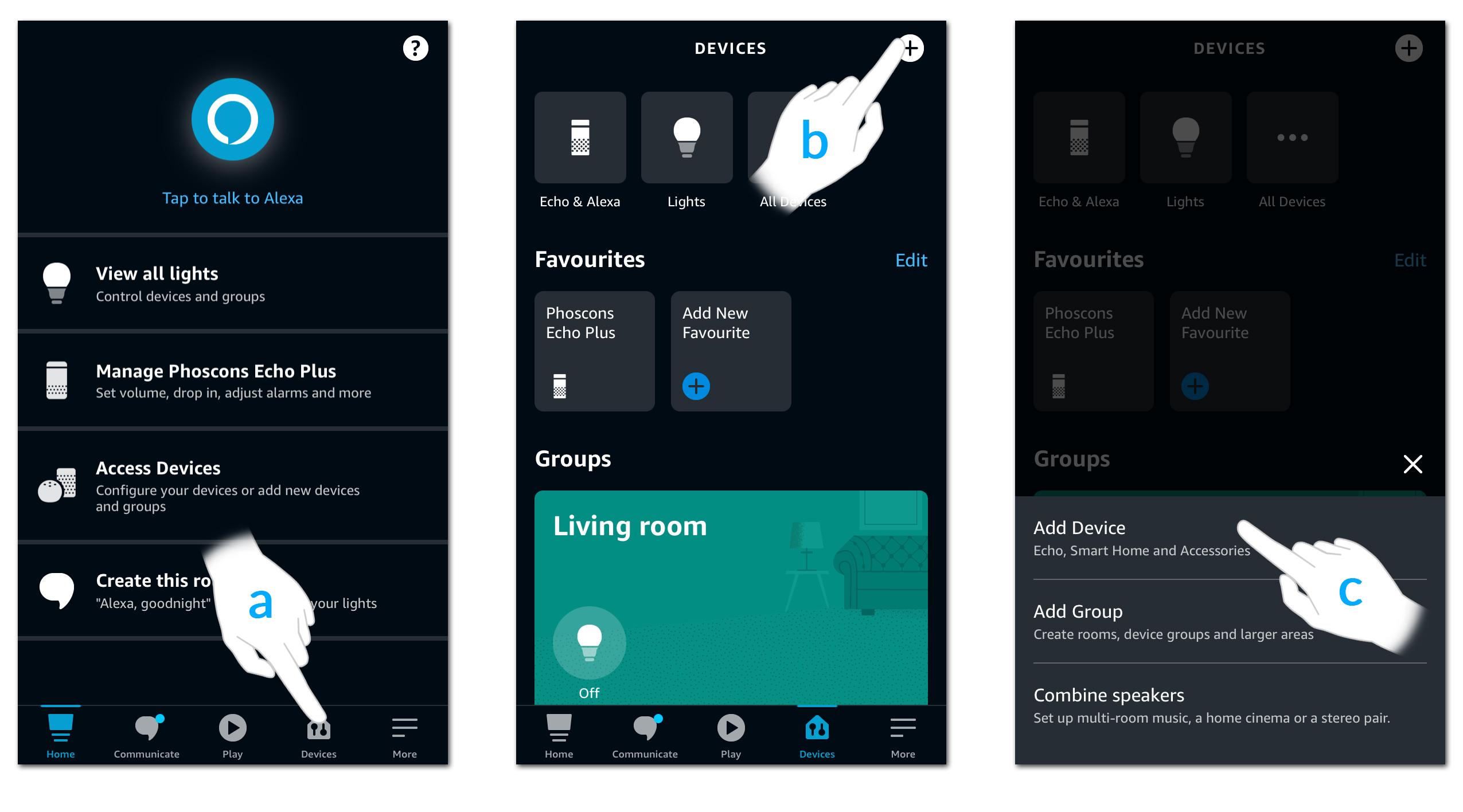

Open Amazon Alexa app
Add a new device
- Devices
- Add device

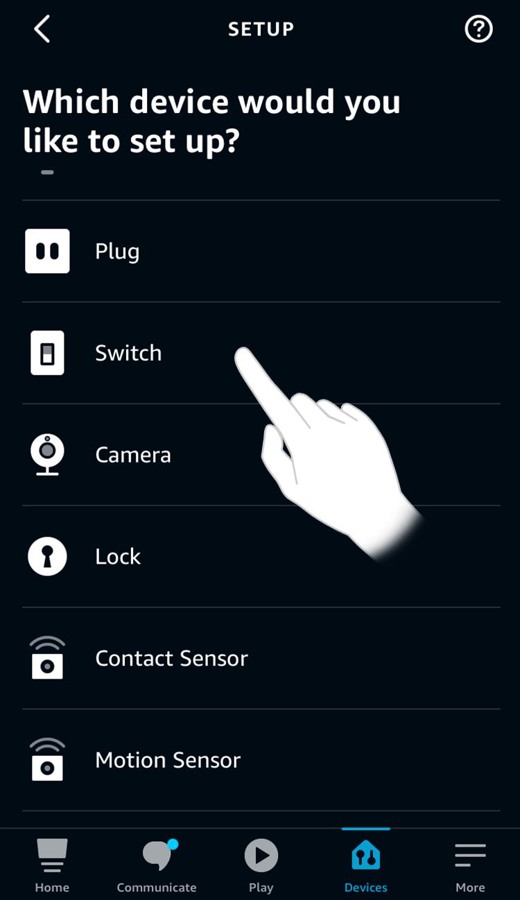

Connect the Kobold as a switch. Select
Other
for the brand and start the device search.Briefly press the Reset button on the back of the Kobold 5 times.

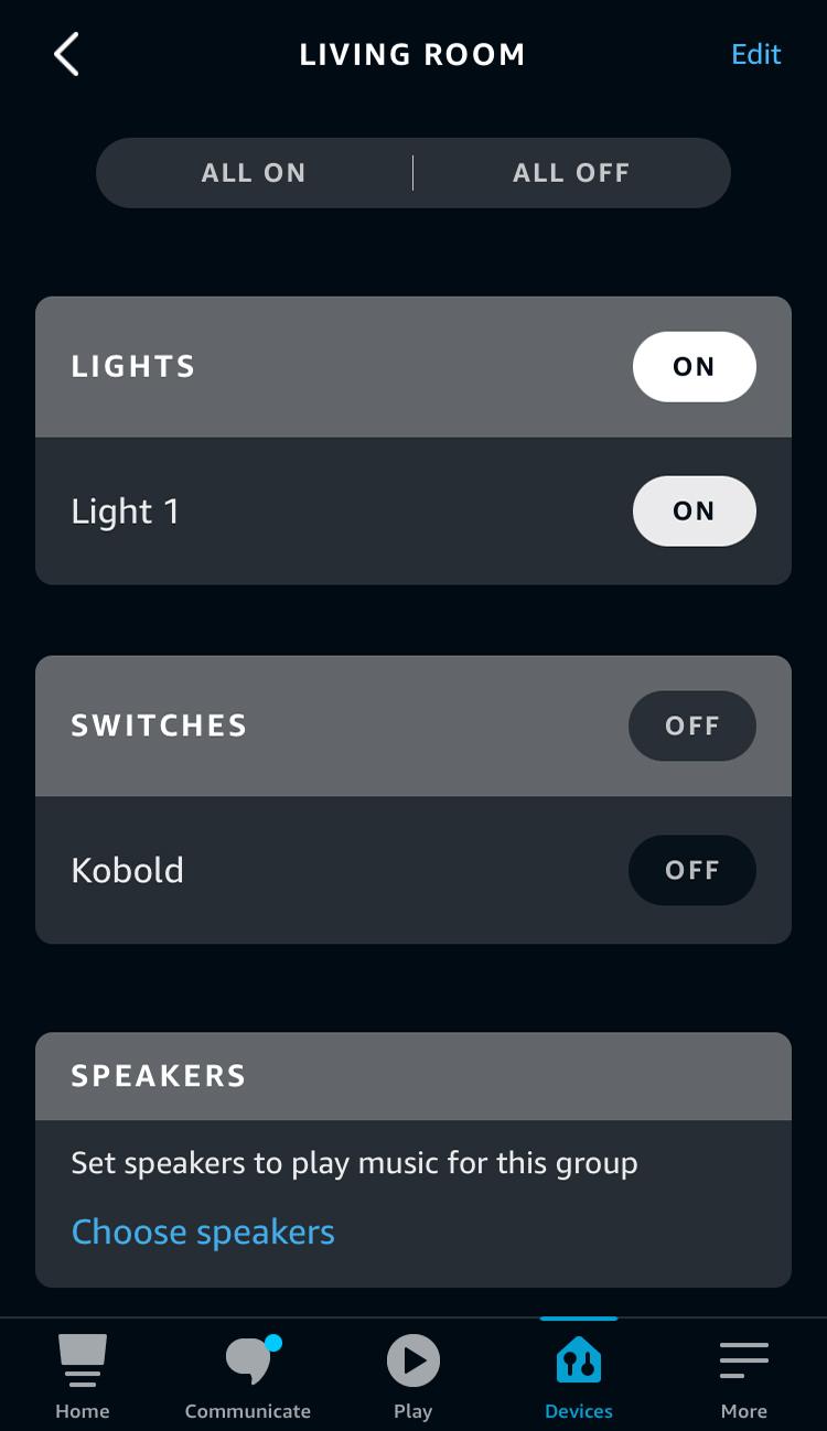

Finally, add the Kobold to a group to be able to control it together with other devices.
